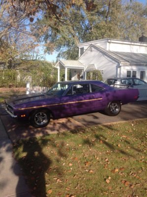

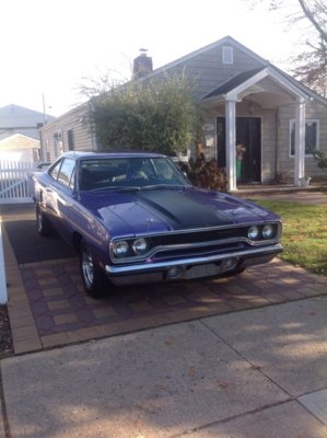

IMG_0011.JPG IMG_0010.JPG Thanks for th info and here are a couple pictures of my 70 roadrunner 440
301
Postcar...sweet! I've delt with Passion, Jamie is a great guy. And never heard any bad about Brewers.
