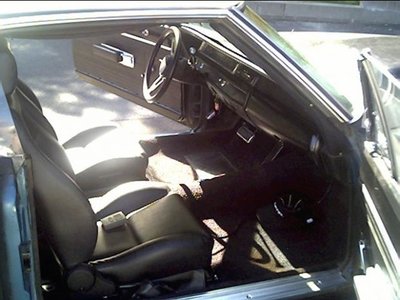

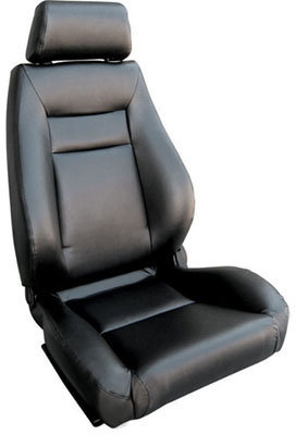

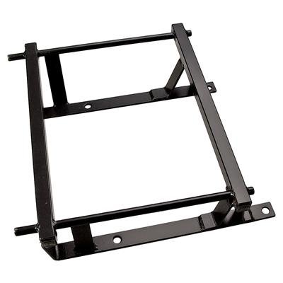

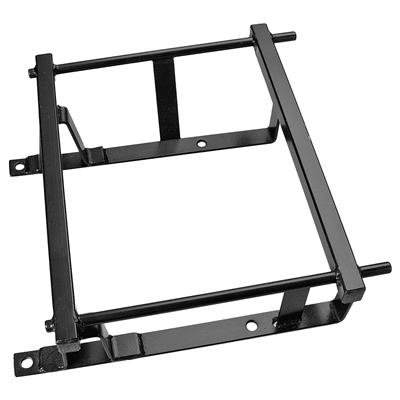

I have ProCar/Scat 1100 Elites, with adjustable head rests & backs, on sliders in my 68 RR, with their seat Bucket seat slide mounts, it was about $750 total a few years ago now, they have gone up some since then, Jegs & Summit Racing sells them, pretty reasonably priced & nice quality they have a couple different styles...
