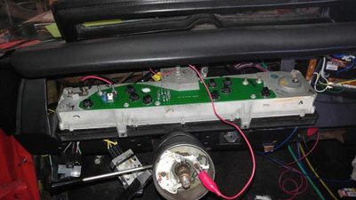

Snap a pic of that cluster. It doesn't sound close to stock.

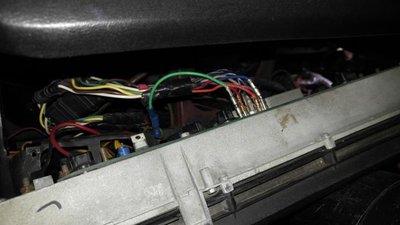

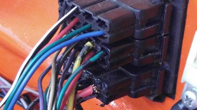

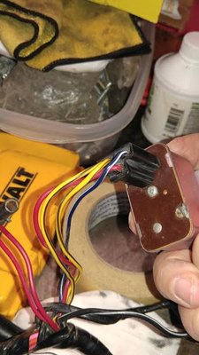

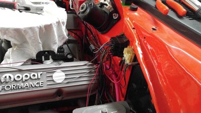

Decided to go with a yearone harness. Heres why and heres what I started with and where the car is nowDonny V10 571.jpgDonny V10 1208.jpgDonny V10 1211.jpg
without a doubt wise move getting a new harness.
WOW! That bulkhead connector has seen better days. Mine is OEM and still looks good, nothing like that.

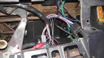

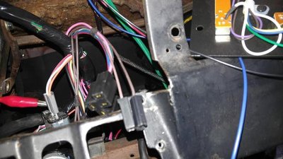

I have a weird issue. My dome light stays on constantly. The jamb switches are not even installed, the Yearone dash harness is in but I had to improvise the plug to the turn sig switch. I have an orange wire left over.....hum? The thing is all of my headlights and turn sigs, brake lights all work fine. Just can't get the dome light to turn off. The schematics that are offered on the internet are junk. Mopar has the most idiotic wiring I HAVE EVER SEEN!!!! I have these black wires with female bullets that run with the door jamb switch wires with male bullets but stop WAY short of them. I have an orange wire with three female bullet ports, I have a red wire with one female bullet port behind the glovebox. I have 4 brown wires female spade plastic insulators behind the cluster right side at the washer/wiper switch. I am missing a wire female spade for the horn relay. But if I add power to the horn brass tab at the turn sig switch it blows WTF????? Unless I am just WAY to used to simplicity of GM wiring that's wrong. Something feels like I have a back flow circuit. But if this were the case why am I not blowing fuses? I am so lost on this system! I have an original wiring book from yearone to be here next week so I hope that helps, I am not optimistic seeing what I have seen so far from Mopar. I wish I had just converted it over to GM wiring like I started to do in the first place!
Let's take the issue one part at a time.
First, dome lights. The dome lights have +voltage to them all the time and no ground. The yellow wire to the door switches returns ground and lights the lamps. Chances are, if the switches aren't hooked up, the wires or connectors are shorting to ground somewhere. They may even just be laying against a ground. That's all it needs to stay lit.
Orange wire at the steering column is easy. It's the light for a column shift "PRND21" indicator. You may or may not need it, I don't know how your car is equipped.
Power to horn at steering column. BTW, that column is a GM (Saginaw) part, so you would have this issue with a GM car. Simply stated, there is no power to the horn switch at the steering column. There is a black wire with a white tracer (stripe) that returns ground to the relay. The relay is mounted out near the horns and gets power from the harness at the alternator. You aren't missing anything. You blow the horn, it grounds the horn "switch" and makes the relay work.

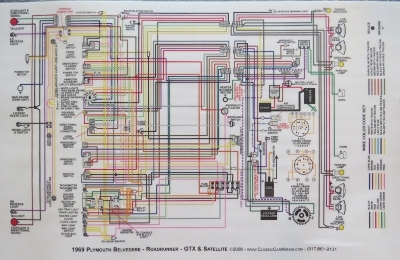

The wiring in your Roadrunner is a lot simpler than you may think. Here's my suggestion. In our reference section is the complete factory service manual. It's also available on Mymopar.com in a zipped format to download. Either way, download a copy.
Go to the electrical section and print out a few copies of everything that says "Belvedere or Satellite". The instrument panel section is two pages and makes a lot more sense when you hold the two pages together. Get out your hi-liters and start hi-liting the wires you need. Note the color codes and the numbers on the wire. For example" H1-16V is the power for the horn relay. 16 is the wire size, V is the color, and H1 is the circuit number. That number makes things much easier... If you are looking at the underhood wiring for the horn and at the the bulkhead connector and you see "H3-18BK*" going into the "L" cavity. The "L" cavity on the dashboard wiring also has "H3-18BK*" Go to the steering column connector and you will see "H3-18BK*" going into the "4" cavity. Physically looking in your car, you'll see a black with white tracer 18 gauge wire at these locations if everything is wired right.

To Mac: As far as the color diagram, I do this with a Highlighter on the more complicated systems so thank you. But the issues were the lack of information the diagrams are showing at this point. Now the link to the book.... YAHTZEE! That one showed the info in relation to my issues with the lack of circuit definition. That helps fill in the gaps tremendously, where the other system had been hacked up. So thank you!

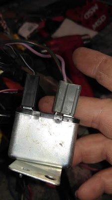

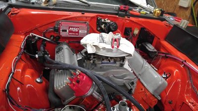

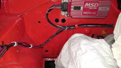

did you remove the ballast resistor when went to the msd box? I just ran into this problem with my car as well. you need a switched circuit for the 6al feed, but almost all circuits are off during cranking so no power to the 6al box and as such no start. if this sounds like what you have let me know and I will email you the solution the wiring company sent me for mine.
