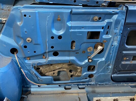

Actually had time today to do some assembly. Was going to mount the convertible top frame but…hardware questions happened. Does anyone have a picture of how the rear frame mount at the rear quarter area?
The mounting plate diagram in the shop manual shows 3 bolts and one nut but I don’t have a stud where the nut should go. Also shows a square shim used on one of the bolts. I’m sure I have the hardware but may be in the bag of misc fasteners so need to sort and hunt but not sue what I’m looking for. Hardware shown in shop manual looks like seat belt type bolts? Are they?
Jack, I tried to take some pictures and they don't come out. It's to tight down in the cavity to get a picture and from the top you can't see much. I'll back it out and lower the top and see if I can get to it better.
Don't know if this helps, but its about as good as I can get. I can't really get down inside, its to narrow to take a picture. This is with the top down.
