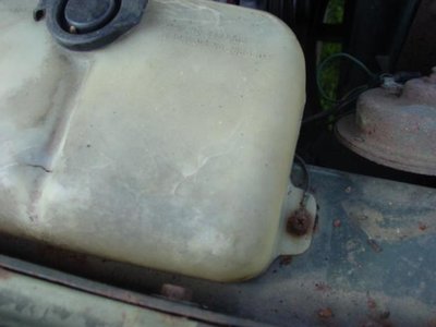

You can see the outline of where it was on a '68 road runner in front of the windshield washer fluid container

And here is the smaller fender mount and hood bumper pad on the '68 models that made it easier to place it there on the same '68 road runner

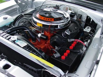

This one is a top placing National winning '68 Hemi road runner of a good friend of mine (he has a heater box I gave him in it that he never paid me for if you're reading this Rick LOL) that the emission label is in the INCORRECT LOCATION, showing that the judges don't even know the correct location.
