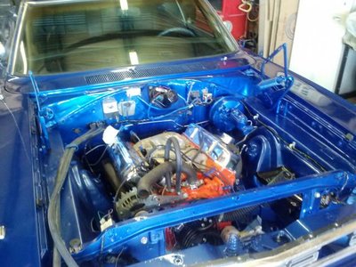

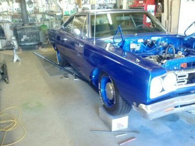

Got the new tires in yesterday, mounted and placed on the car, then today got a little help to get the engine mated with the tranny and slid into the car. Gonna be a busy day tomorrow. Have a 1 inch spacer on the 750 Holley, and looks to be real close to the hood. Anyone else running a spacer with the original air cleaner? Will it work?

I've used clay wrapped in saran wrap before. We've had a few cars that we were worried about hood clearance. Instead of dimpling the hood when closing it for the first time I'd pull the spacer, put the carb/air cleaner assembly back on with the saran wrapped clay on the lid. Then I'd measure the clay to see if it didn't compress below the clearance you need. I used to run an Offy 360 intake on my '70 383 (which was more than an inch taller than my stock manifold) with no clearance issues but that hood is shaped quite a bit different.

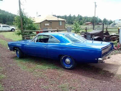

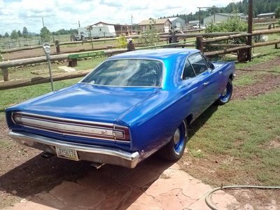

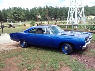

Finally got the '68 out in the sun for some photos to see what it looks like in the sun. No I have not color sanded and buffed the paint yet. Doesn't look to bad for no paint booth!021.jpg
