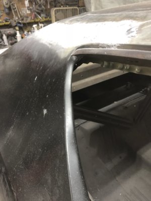

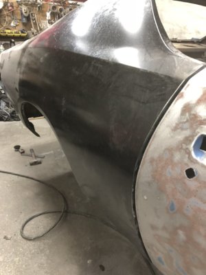

Passenger quarter hung, tacked into place a few days ago. Over the past two days I hung the doors and fenders temporarily to make sure the edges of the quarters had the correct contours to the door edges. Finished final spot welding on both sides. Started work on the doors and fenders today and did the lead work on the tops of the quarters at the roof seam
I buy a great deal of my supplies from Eastwood, then some things like the paint at the local Kemperle auto body supply. In the case of the lead, I used the Eastwood lead kit, which uses 70/30 lead sticks. You might be thinking of the "lead free Solder" but I don't trust that stuff. The real lead flows nice, shapes nice and makes for a great foundation at those critical seams. The hard part is getting the area really clean, especially in all the little recesses and between the welds.

I used the led free on the upper cowl to A pillar's. Going to use all steel on the rest of the Lead joint's. Don't like heat on my treated metal. After looking at all the old car's that they used lead on. It seam's to be where they rust out firs or worst. How ever you look at it. Look in to the cold product's being used in stead of lead or solider. Will let you know how it turn's out. So far looking good on your car. Still have to cut and fit these AMD parts so things will fit rite. Keep up the good work and the pic's coming. :thumbsup:

So, been a few days since my last post but I have been working every day on this project. As of last weekend, front and rear full floor pans done, full trunk pan and both drop downs done, both full quarter panels done. Now onto the removable panels- both doors, both fenders and the trunk lid. Forgot I never finished stripping them before it got cold out so as weather has allowed I have been blasting them on all sides. Of course found hidden old work that I did not know was on my so called “clean panels” so now I am doing repair work to them as well. On the right front fender it must have been hit at one point and repaired as a collision job. I found 14 holes drilled under body filler, holes used to attach a slide hammer from the outside to pull out the dent. It was like damn Swiss cheese dripping with body filler. So, I opted to cut out the whole section and weld in clean metal and grind smooth. Found similar holes in all 5 panels but nothing like this. So every panel has required metal repair and hole welding but today I am hopefully wrapping them up and getting them to bare metal. Here are some shots. My goal is to finish everything up by mid week next week so I can clean up the work area and prepare to apply epoxy sealer primer to the whole car and all the removable parts. Then the work of smoothing everything begins.
Look's good as a body shop would do or probably better because it is your car. Spent all day adding metal to the rear quarter wheel tub lip that the factory cut me short. It was small piece but it had to be done to have enough metal to make the plug weld meet up with the wheel tub lip. Good job. Figure will have at least a month in the body prep before painting. Lot of block sanding. Will spray the hole car with feather filler then fill the low spot's with skim coat. I am using cold joint's on the lead area's that get leaded. Had to use the solider on the A pillar where it met the upper cowl area. No choice. A lot of heat their that make's metal rust oh no rust. Saw where a friend of mine did the quarter to roof joint the next morning rust had popped up way past the joint area. Not to mention what it would look like on the back side we can't see. Looking at all these old cars it seems to be the problem area for most of them. So will let you guys know how the cold joint work's for me. Using all steel compound in these area's. If any one has used this let me know.
Looks good and solid! Nice job on that, we can find lots of surprises under that body filler sadly... I know what I'm talking about with what I found on my birdlol
