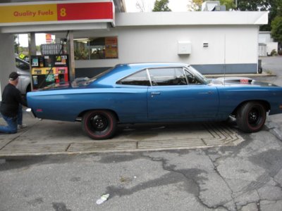

Got my 15 inch from CokerView attachment 30166
Thank you, good sir.
Of course beauty is in the eye of the beholder, and to each his own. I remember that my best friend thought my girlfriend was ugly as sin, but unfortunately for me, some other guys were not of the same opinion. Now to me, the plain factory wheels painted black, rather accentuate the RR body lines, and when the best looking girl in school wears lip stick, it serves little purpose. Yet no doubt the plain wheels would be promptly changed out, by the next owner.

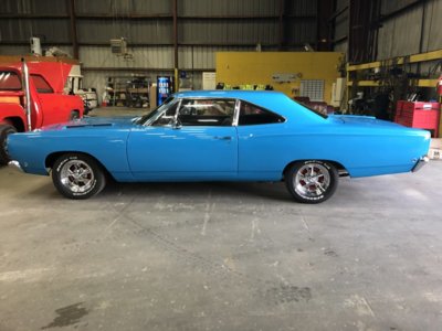

Got mine from summit racing but have the ones with cut out's. Comp. was one set for the rear then Bart rims for the front. 8 inch rear and 7 inch front's. 4 1/2 back set rear and 4 1/4 front. Here is what these look like. This is till I can get my Cragar mag's. They may have them with out the slots. Not bad on the price front two for just over 100 buck's and the rears where not that much more. Hope this help's :thumbsup2:View attachment 30160

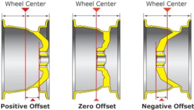

I hate to deviate from my original question, but can I please trouble you to clue me in on what "back set" is? Thanks!

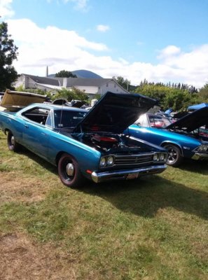

Some times I use hub caps. and41788482_1831372190261880_1201555059976962048_n.jpg 41788482_1831372190261880_1201555059976962048_n.jpg DSC_0571.jpg some times 14 inch road wheels .

Yes rusty roller. When buying my runner the guy said he would knock off 400 if he kept the rim's. He had a set of rims looked like off a 72 or 73 runner. The car would not roll then they where binding on the tie rod ends. Found that when getting home. It moves the tire in or out in the wheel well's. This give you clearance for the bigger tire on the rear and front end.
