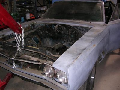

I have been hired to put a original owner 68 runner together, it was given to her new in 68 as a graduation gift. Her husband pulled quite a bit of the car apart and then passed away three years ago and she is quite excited to get it back on the road. My first question is the 383 is #s match to the car and she wants to run pump gas. I just checked and it is zero deck flat top pistons with 906 heads that have never been milled. With a standard felpro gasket which I think is 40 thousands and a cam slightly larger than stock. Will it ping?

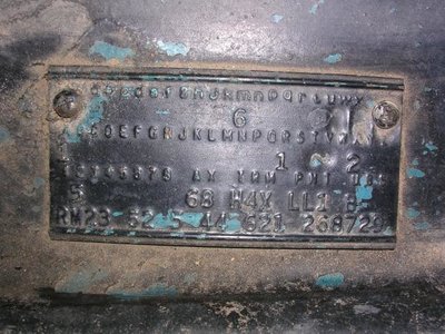

LL1 Surf Turquoise. Bet it was sharp when it was new.
I talked her into going back to that color. Her hubby was a painter so it saw gold and olive of all colors, I also told her I wasn't going to work on it with a black engine bay so it going in for paint soon :D

The engine is pulled and she wanted the car the way she got it (Surf Turquoise) There is no reason to leave it flat black when the black is in bad shape so it needs painted. She is overly excited about getting it running I have to settle her down and do things right. If your engine bay is black that's fine and I wouldn't pull the motor for that reason but this one is apart and begging for paint. I am a bit of a purist in that respect but that's just me, and my name is going on it. Thank you for your input on the 87 octane we have pretty crappy gas here.
