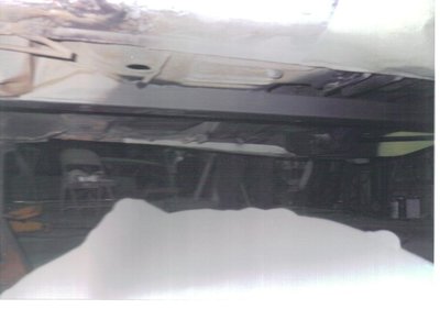

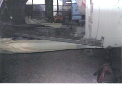

I have heard good things about Us car tool connectors , Mopar also makes a set . with a convertible they are a must have .
I made mine out of square tubing and they work great

Looks good Stu!
I agree the connectors are a must have, especially with the vert. I'm going to order the US Car Tools connectors this week.
