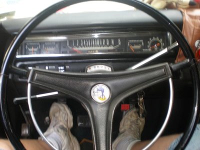

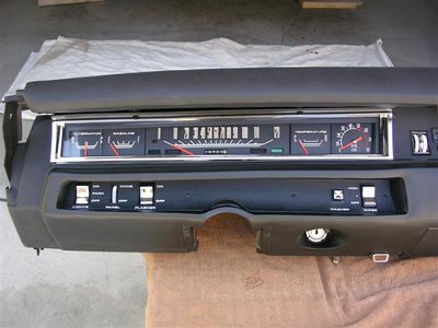

I know my car had an old school tach in it, I was wondering if there was a way to retro-fit a "factory" in dash tach into the car. Is it just as easy as bolting it in and hooking it up to the tranny? I know I am going to need a tach to learn how to drive this beast and Id rather have a clean in dash look than a bolted on version...

They repop them and its pretty easy to wire. BUT they are $239 at Laysons and a harness is $46 I believe. I think it would be cheaper to find an old one and have real time engineering redo it and have it updated for accuracy

My opinion, but I was going to go with the factory tach in the dash; but think about the location and the size. Not going to be very easy to read when you're banging through the gears. I'm going with a column mount so it's right in front of me and I don't have to squint to read it. Just a thought.
