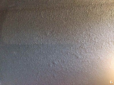

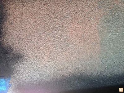

Tried a few products and wasn't happy. Researched and this came highly recommended. I had one quarter with factory undercoat and another without. Product came in a gallon screw top can that had glue left on where original label was ripped off. Took a lot of stirring as everything was thick and heavy on the bottom of the can. I poured it into a gallon paint can and then into an empty body schutz can. Used 3m body schutz gun and set my psi. Sprayed beautiful. Thick, textured and just like factory. Was $65 a gallon but we agreed it was worth it. Orange/brown undercoat is factory, black is new product. e8amadad.jpgpyzadabu.jpg
