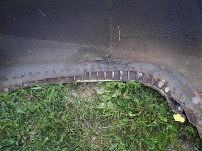

Going to replace the quarters on my 68. Original owner cut out the wheelwells a little to run wrinkle tires and I don't see the possibility of fabricating to fix the problem (unless some of you guys have had sucess doing it). It's a real shame, for the car is rust free basically. Who has the best prices on skins? I've seen some cheaper on ebay, but not the best seller reviews. Living in Az causes me to be concerned with shipping cost also, so I don't really want to pay an arm and a leg getting something from the east coast. Outer wheelwells will need replaced too. Fixed the trunk/inner wheelwells where he chopped a piece out there too and shouldn't be too noticeable. Shame too cuz it's a number matching 4 speed car. Sure appreciate help in saving some cash if you have any good leads! Also, will need to replace all the brake lines, cables and the list goes on and on. Thanks again. Jerry :nopity: :jail:

If you want to just patch your 1/4s, maybe you can use parts of my old ones. just need a box of rivets....... :eek:
That's called GREEN welding, no electricity needed :lmao:
I think you're right. there wasn't one sign of electrical welding, or even torch work by this rivet/bondo master :facepalm:
