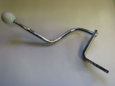

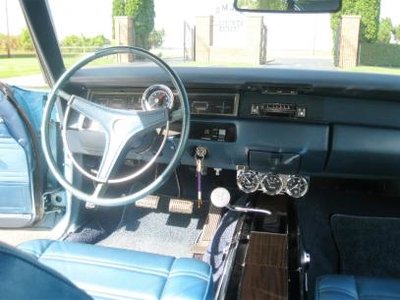

DO NOT modify your console. The console shifters are offset (under the console) to allow for the shift handle to come up through the center of the console and then offset again to bring it back over where it comes through the tunnel.
Like this one.

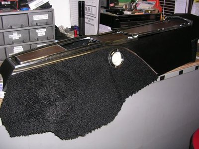

The 4 speed console covers the hump.
