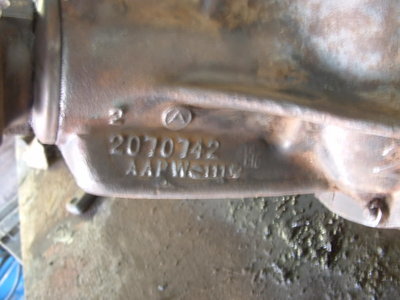

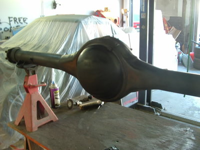

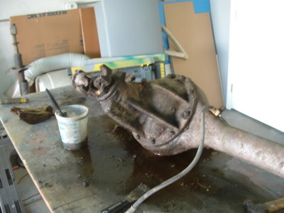

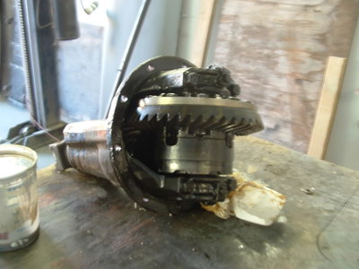

Pulled the rear end apart. Gears look perfect.
JJRJR
Sep 3, 2011
696

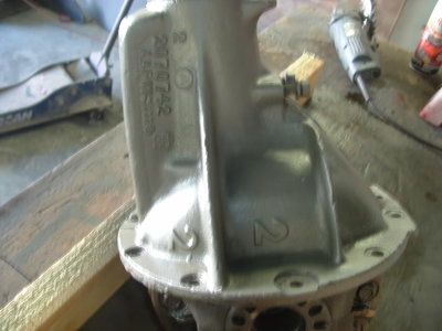

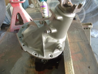

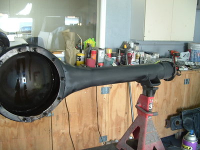

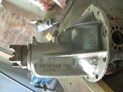

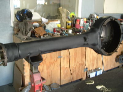

Turns out it's a 3.23 Sure Grip. Gears and Axles in perfect shape. Sending axles off to get new green bearings installed then reinstalling everything. Rear housing being primered and painted today I think. Cleaned up very nicely I think.
