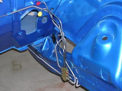

does any one have any oics of what and where a proportioning goes, a friend give me one but it is long and he does not know if it goes on a road runner.

What type of car do you have. The picture is a distribution block with safety switch. Normally disc brake cars with drum rears have the proportioner and it is a smaller block going between the distribution block and the rear brakes. Different models used different setups and there are after market parts that combine it all. So your brake set up and model car matter. G

Thanks! This just helped me out. New frame rail cap means I have to relocate the holes for the block. New inner fenders means new hole for bolt that holds passenger side brake line to inner fender. Does yours have that? Mine is a lynch road manual drum car

Its hard to see the bolt but the bracket also holds the speedo cable
