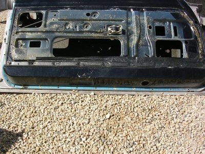

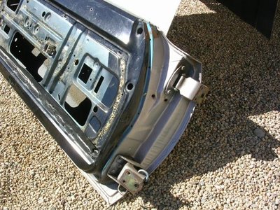

If I paint the door's and the interior is all black how much of the door do I paint with the car color. Was going to paint the inside of the door all black. Well what do you Guy's think. Russ. :popcorn:
22,223
2,463
Top bottom and sides to the weather strip that the door panel don't cover
