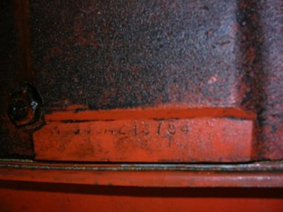

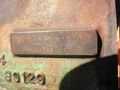

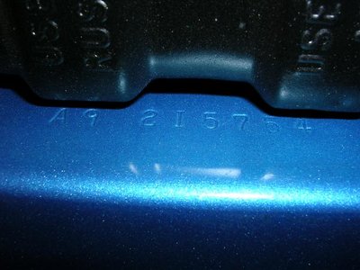

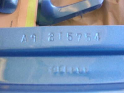

Your VIN should match the partial VIN on the radiator support and left trunk lip under the weather strip for body #s. And if your Engine and trans have the full VIN and the Diff is date correct you have a #s match drive train. Then if you want to go crazy every thing on the car has date codes.

Oh Bill and Ray I used the pre restored greasy pick cause its easier to see. :bart:
Bill, I'm pretty sure he just slid under that dirty girl and snapped a pic yesterday...whatta you think...? :lmao:
BTW - you have a bolt stuck stuck in the side of your block. You might want to get that looked at...:basketcase:
