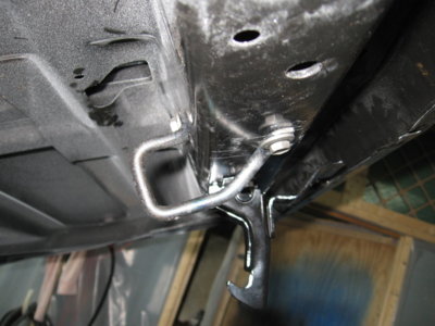

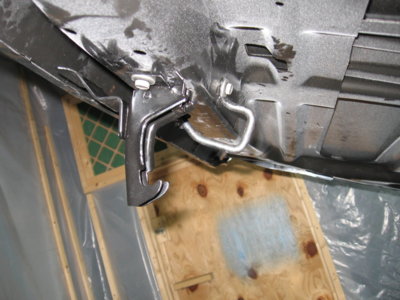

Found out the part the striker would mount to on the new hood was 3/8 inch shorter. So got my tools out and made this one. Did have to go to my friends house and have the rod turned down to size. It was 32 thou. bigger. When done bending it in to shape heated it cherry red and dipped it in an oil bath. To harden the steel. Now the hood latches and in the rite position. So here is a few pic's of it mounted. The safety latch is a little off also but can live with it. It work's. So here is a few pic's. IMG_0101 (1).JPG IMG_0102 (1).JPG

Now who has black smith blood in them. That is thinking out of the box for sure. That show's if we want it done we will find away to get her done. :thumbsup2:

Custom made part's are expensive you know. Just kidding. Man just was glad to get one made for this runner. Sorry no order's please. It was hard enough to make this one off. Thanks 69hemibeep.
