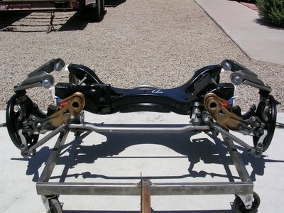

I will be tearing down the front end and rebuilding with poly bushings and disc brakes. I'm sure I will need a ton of help and advice along the way.
On that note, does anyone have a paint in "natural" and also a paint in the color of cosmoline they would recommend? I want to rebuild the front end to look as close to factory as possible by mimicking the appearance with paint. The K member will be painted, not powder coated.

I used powder coat on the K- frame but its a satin finish which is more correct and they do get dirty so I suggest that over paint. For the gold finish I used a series of paints but I hear the best look now is battery terminal spray like Auto Zone carries. As for natural I used Aervoe engine enamel Cast Iron Gray, And if you need a Cast Iron color I suggest Aervoe Steel Blast, I know it sounds backwards. Also the upper control arm cam bolts should be black phosphate, I re-plated mine before they went in.
