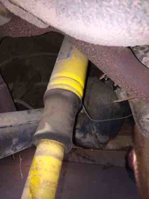

Anyone familiar with these? Car has aftermarket air shocks and I can't find a PSI rating anywhere.
Best thing to do with those air shocks is to take them off the car.
The shock mounts are not made to support any weight. I have seen a number of upper shock mounts torn up and in need of repair because of air shocks and shock mounted "helper" springs. If you are lucky, it just tears the bolts out... If you are not so lucky, the upper mount tears and needs replacement.

That happened on my first Road Runner back in the day. The previous owner had air shocks on the car which broke the mount on one side. His "fix" was to bolt that broken end to the trunk floor which tore it up, so I was stuck replacing that mount!
300
anywhere from 90-150 psi. you don't need anywhere near that much air in them unless you're planning to pull a 40 foot camper. I've run air shocks for years without anything bad happening. I've seen tore up mounts like the others have said, but if you're just after some rake, then put 50 psi in the shocks and be done. but the better idea is to replace your springs, or add an extra leaf or two.

Thanks for the quick responses. We put 40 PSI just to be safe and to see if it held. Will probably dive on them and keep a close eye. No problem if we need to replace them either. Will probably do that before finished anyways.

Big john is absolutely right. The upper shock mount crossbar is not strong enough to support the car. Which is what it is trying to do currently. If you are a welder or have a friend who is, you can beef up the support, or switch to an aftermarket 4 link, or as john suggested add an extra leaf or so.
