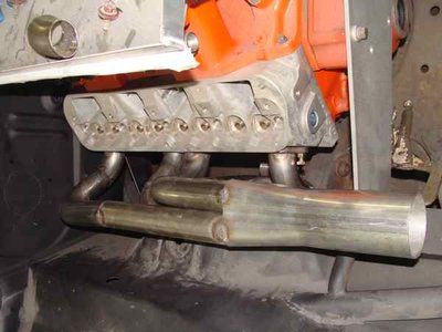

I was able to get some std port victor heads so I am making some 2.250 headers fender exit.

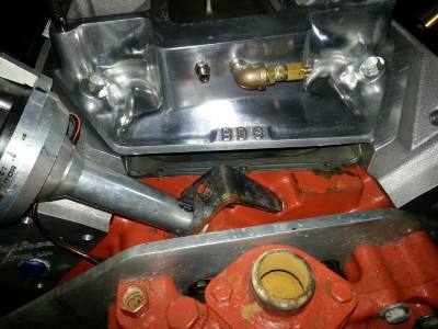

With the motor plate it gives you more wiggle room with the engine not moving around, looking good :thumbsup:

peresvet24 said:
looks good! :thumbsup:
but I think that the exhaust manifold is too big.
do not you think :huh:
Not too big,just 2 1/4" for about 1200HP
started welding,this is 1,3 pipe.

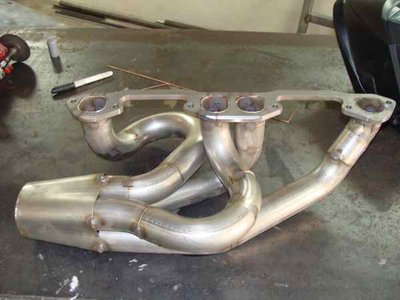

I love building headers. Make sure that the fella who is going to weld them, back gases the header so that you dont get contamination on the backside of the weld (inside the tube) if not they will crack at the welds. Here is the set I made for my Turbo Dart.

I watched a welding video where they were doing back gas process and it sounds like a PITA to do but needed I am sure.Thanks.
I will take a picture of my set up. Its really simple. Just buy a tee and some extra hose at the welding store. I use masking tape to block off the ports. BTW your headers are looking really good!!
