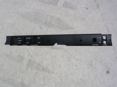

I have a refurbished panel but no switches. PM me if that's what you need

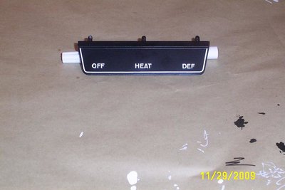

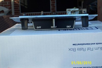

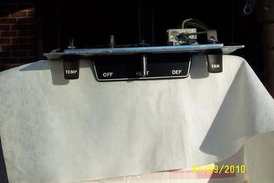

Anyone doing the heater,temp,defroster controls (non A/C) I can't adj. the temp anymore in mine and it looks like crap.

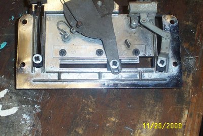

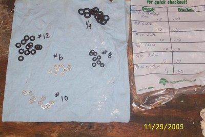

That controller is not that hard to do. After removing the cables from the slides remove it from the dash. Those clips can be a pain sometimes to remove. The pieces are held in place by push nuts. Simply pry them off taking care not to break the tabs. New push nuts are available at Sears Hardware thats where I got mine from. Using the fine point paint marker from a hobby store paint the DEF, HEAT and OFF as well as the white trim. THe FAN and TEMP are actually decals that someone is reproducing. I can't remember who at this time but will look when I get home from work tonight. It is someone in Canada.if I remember correctly. If your cables are stiff you can try some lubricant and work them back and forth to free them up.
