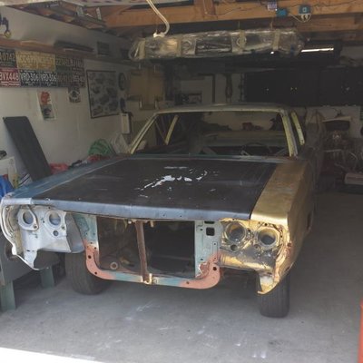

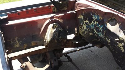

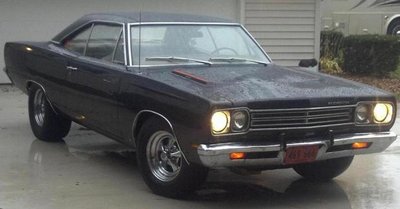

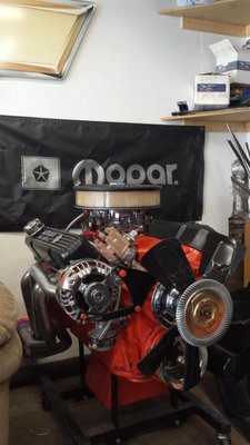

Figured if Im going to ask for help, with most everything. Figured Id fill you in once in a while.

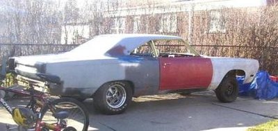

Those are the pics I had just off my phone. But back story is I gained the car from my fathers passing back in 05' but only being 15 there was no way so she sat in a garage waiting, But I think its time I start hunkering down and putting time into her, But I Dont know where to start I know body work needs to be done first. But Figured youd like to see the progress on her. Thanks! any questions comments are wanted.

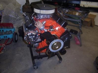

The motor looks damn good which is a good start ! Body work for me was trial and error and of course lots of u-tube videos , after a while my work started to look pretty good . Buy a gallon can of bondo and start filling those imperfections and keep practicing . Like I said , if you plan to do the body work yourself almost everything you need to know can be found on utube .
300
looks like your hood is a '68, the inserts are different from the '69s. There are plenty of places to find parts anymore. Do some looking, plenty of prices too. If you get the chance, the Mopar Nats are in August in Columbus,Ohio. Not a bad drive for you. Tons of new and used. Good deals, but you have to shop around.

Thanks. I'll have to check the fender tag I know that I put that away in the house. I had to re weld the inner fenders back into the car. The goal is finish body before working before working on finding parts. But back in the 90's the previous owner got drunk and put a pole and a truck trailer into the quarters. And did a horrible job with the bondo. I've did some local searches to find factory cut quarters but I found one place. But there metal wasn't the best. Any suggestions?

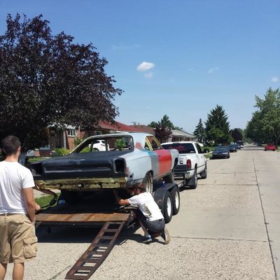

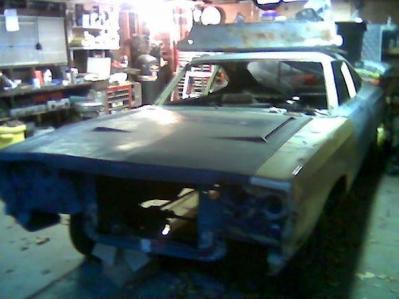

Update

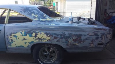

Picked her up from where I was storing her. Now on to body work. Driver side quarter was better then expected

I love the multi colored look, seems like I had one multi colored car since I was 16.
