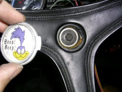

If your talking the pad with the roadrunner in the middle you have to pop the roadrunner out with a small screw driver to get at the bolt. And start at the left side because there is a tab on the right.
Yep, what Bob said. :thumbsup:

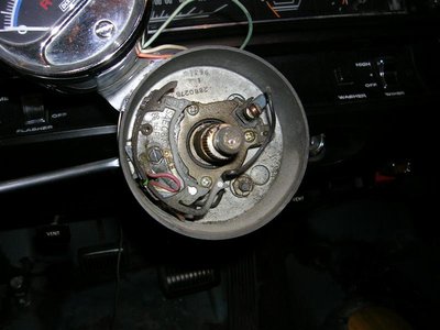

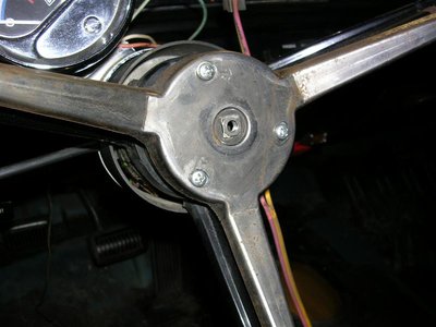

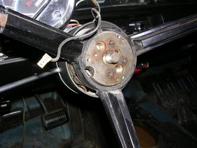

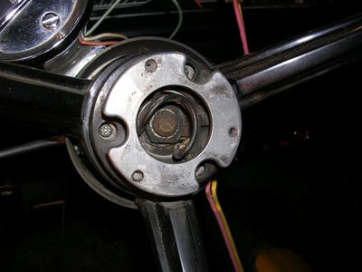

Did you get the pad like mine, I have a sequence of pics as how it goes together or go to the reference section.

I'm not sure, but is your pad the same as mine?
22,217
2,455
Make sure you get the right horn switch with the three screw holes for the horn ring
