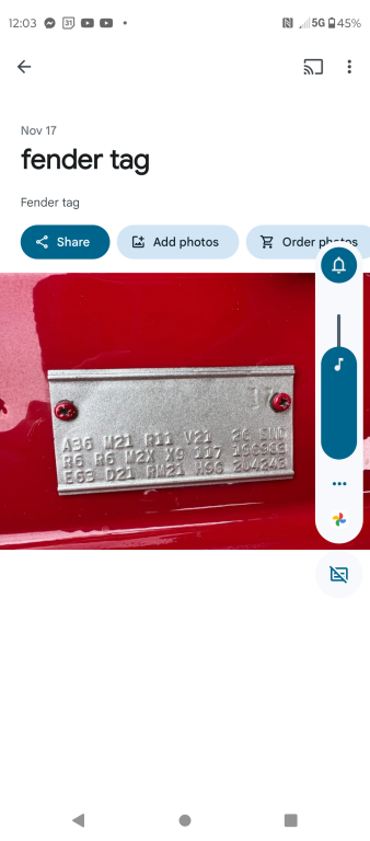

Newer to the hobby (new to the Forum) and I could use some help with fender tag decoding. Any help would be appreciated. Thanks!

RM21:
Plymouth Belvedere, Satellite
Medium, Road Runner
2 Door Coupe
H9G: 383 330HP OR 335HP 1-4BBL 8 CYL
1969
St. Louis, MO, USA
: Sequence number
E63: 383 cid 4 barrel V8 High Performance
D21: 4 Speed Manual Transmission
R6: Red (Dodge), Scorch Red (Plymouth), Crimson (Chrysler) Exterior Color
M2X: Trim - Opt. Decor Group, Vinyl Bench Seat, Black
X9: Black (Dodge), Black Velvet (Plymouth), Formal Black (Chrysler & Imperial) Int. Door Frames
117: Build Date: January 17
: Order number
A36: Performance Axle Package w/3.55 Ratio
M21: Roof drip rail moldings
R11: Radio Solid State AM (2 Watts)
V21: Performance Hood Treatment
26: 26in Radiator

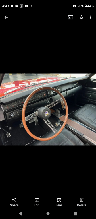

Thanks for the help! I got part way through and I couldn't figure out a couple of them. Obviously if there are OEM looking bucket seats with a center console those were added afterwards??? Thanks again

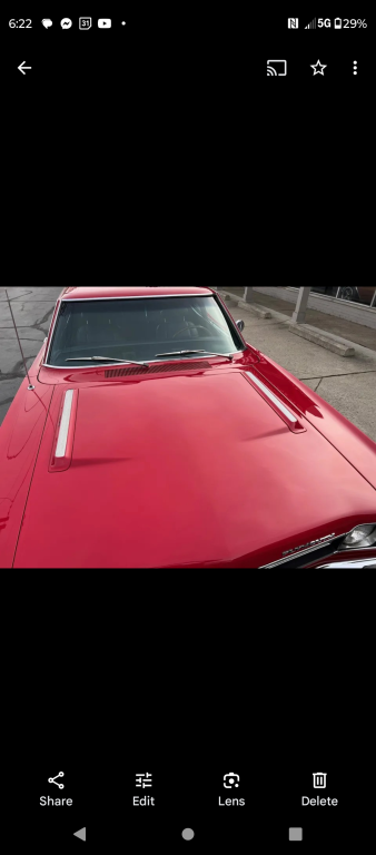

Looks like it was changed from bench seat to buckets/console and missing the Performance Hood treatment. Nice runner though!
