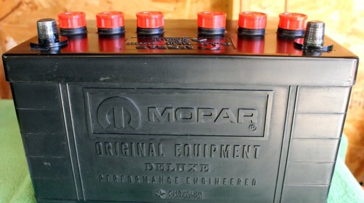

I have, or had as the case may be, one of those replica Mopar batteries. I liked it as it made the engine bay look authentic. My understanding is they are no longer making this product. )-: The battery in its defense was 5 years old, kept on a tender, but just no longer holding the charge.

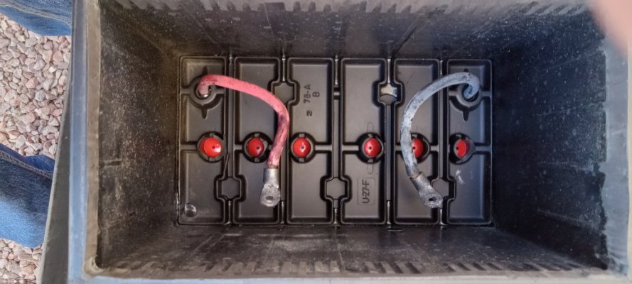

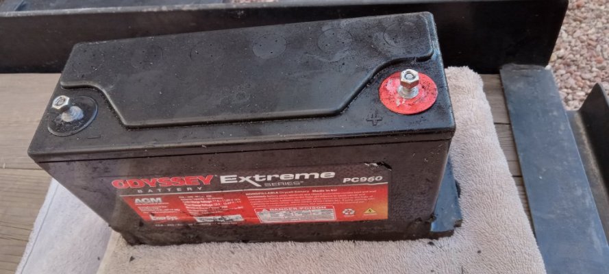

That's what I have but I cut the bottom out and put an AGM battery inside. The first one I did was an AGM it was messy and I drilled pilot holes for small lag bolts and cables The newer version of that mopar battery has an AMG glued to the bottom and cables already. I thought it was kind of light and the caps unscrewed revealing the cables and battery. These pics are the second one.
