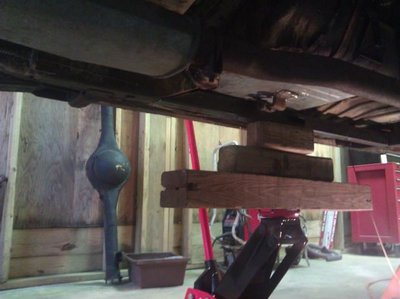

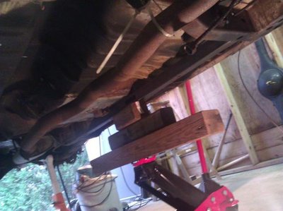

Rapid Transit
Just A Traveler In Time
Feb 9, 2015
475
464
You can weld them in from Auto Rust Technicians. But it's a PITA to do it from under the car.
And not as good as it could be.
I only did it because I'm going to a 440 and had to replace the rear floor pans.
If your car is pretty much stock, the rockers and metal is sound, I wouldn't think it is necessary.

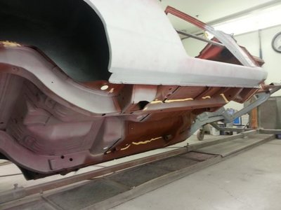

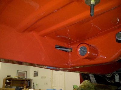

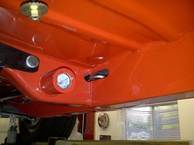

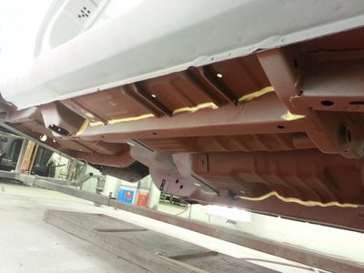

chapdog105
Jan 23, 2010
636
Detroit, MI

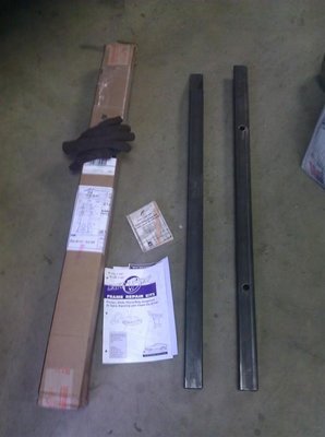

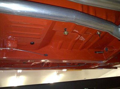

The US Car Tool frame connectors are the way to go.
You will need to make some modifications to a few lines, which you may be replacing anyway.
Here are some pics of mine that were welded in during the rotisserie restoration, then the modifications that were made in final assembly.
