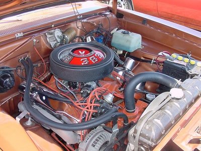

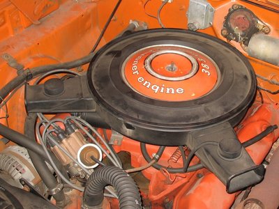

Guys, where can I get a new breather? I'm using the MP valve covers. My recollection is that the breather had a hose coming from it attached someplace, but don't know where. The shop it's in now agreed with you guys that I need both PCV and breather, but I'm going to add the breather myself. Any help? Maybe a pic of where the hose from the breather attaches? It's an open air filter on a ProSystems carb.

For the stock location of the hose off the breather is the air filter top cover on the side of the housing. But for your setup the hose usually mounts to an adapter to the bottom of the lower air cleaner housing.
