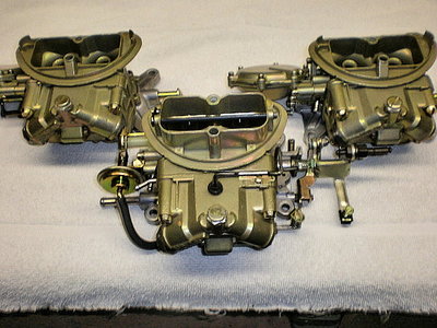

Haven't done anything constructive to Bambi in a while so I got motivated this week and sent my carbs off to get replated and reworked. Thought about going to Harms like Bob & Steve have done, but there is a guy on the LOH Playground that does the same stuff and he's a bit less expensive. He doesn't advertise - says he'd have too much work then - and is retired so this just keeps him busy. Very busy, based on what he told me. :lol:
I managed to cobble together a set with date codes that are good for the car and only a total of 17 days apart. I know some of you like this stuff so I'll share with you what I ended up with:
4391 - center - dated 1209.
4393 - front - dated 1219
4394 - rear - dated 1049
April 14 - May 1 date codes.
I'll post some before and after pics when I get them back. Maybe it'll get me kick-started on some of my other projects...

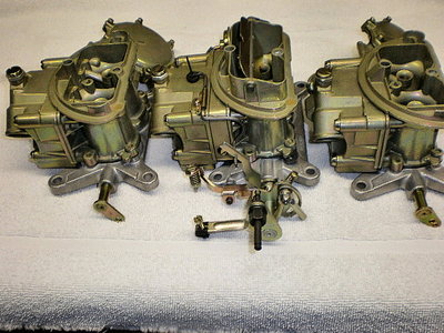

Got the call yesterday. Everything is serviceable except the center carb throttle shaft. I knew that already, though. Some a$$hat cut the lever for the idle stop solenoid off... :toetap:
Still about $75 cheaper than Harms even with a new throttle shaft. :banana:

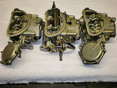

Ray what are those rated at 500cfm and 2 @ 250 ?
Center is 350 and outboards are 500.
I seem to recall seeing something on the LOH Playground some time ago that stated that the total CFM was actually around 1,180 or someting like that...but don't quote me on that...my memory isn't what it used to be... :D
