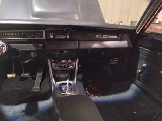

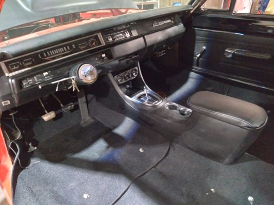

For those looking for a more modern console, here are some pics of the console is installed in the road runner. I also have an e body slap stick shifter inside the console. There is a small piece of rubber seal to be added in front of the shifter face plate to take up the gap that is there.
There is basically no adjusting for the console itself. It fits nicely under the stock dash (non a/c). Just make some brackets to bolt it down. My car was a non console 4 speed and I removed the 4 speed hump. You may need to remove any existing brackets. There was quite a lot of work getting the slap stick shifter in and fabbing up linkage (not using cable) to the work the trans.
