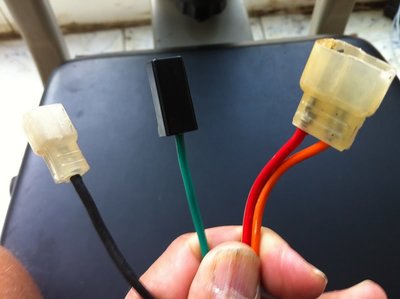

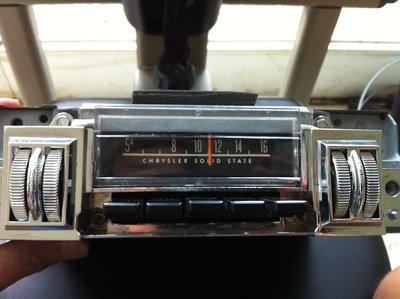

Hello All,
I just purchased the AM radio that is suppost to be in my car but the wires are not labled. I was told that the radio works but the connectors in the dash are long gone. Would someone be able to tell me based on the wire color whats what. Thank you.
22,252
2,497
Without looking at the schematic in the reference section, black and green are speaker, red is ignition hot, and orange lights

:lmao: Yea, the only wire im hooking up is the orange (lights) one. Eventually I'll get some tunes but for now I just wanted to fill the hole I had in the dash.
