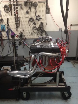

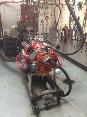

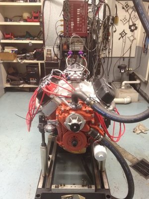

Well, theres some good news and some bad news. The bad news is that they ran the engine on the Dyno today for about 10 minutes and discovered an oil leak. They are sealing it and letting it set over night then they will finish the run tomorrow. Engine Builder will fix when he gets it back. The GOOD news is not only did it start, the guy running the Dyno told me "she sounds pretty $*%KING healthy." LOL
Should have the numbers tomorrow.

Eddy heads? curious to see what power you make. what else do you have the to rotating assembly? I also see you have a new mech fuel pump :) I am going back to that ordered a new eddy 1723. Motor looks great!

Hopefully I'll have the numbers today. Eddy RPM heads, hand ported (picked up quite a bit of flow), .030 over bore, 750 Holley Double-Pumper, Eddy RPM manifold, Comp Cams 275 with 1.6 ratio rockers, 9.8:1 CR flat head pistons (I was hoping for 10:1, but told he only got 9.8), fully balanced assembly, and polished TTI headers. I'm hoping for some nice numbers. I'll keep you all posted.

Short but sweet. At least it sounds nice. Not happy with the numbers so gonna change the carb and maybe the cam, but . . .

i realy like watching the dyno at work.you realy need to shortin those plug wires thoough and cut down on some of the ohms in the wire.

For sure on the wires, I asked the builder to do it.
