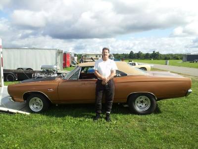

Nice pic metal! It would be cool if you mounted a GoPro on your dash or hood so we could ride along with you :drive:
I see air! the heck with the dash cam, I wanna be in that thing!
