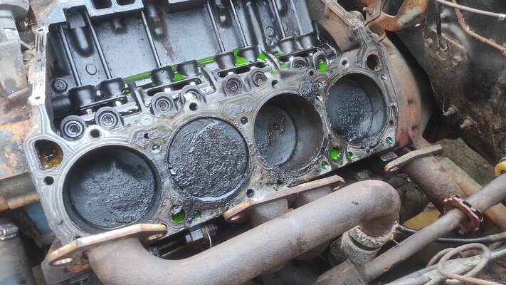

New update guys! Have a happy July!

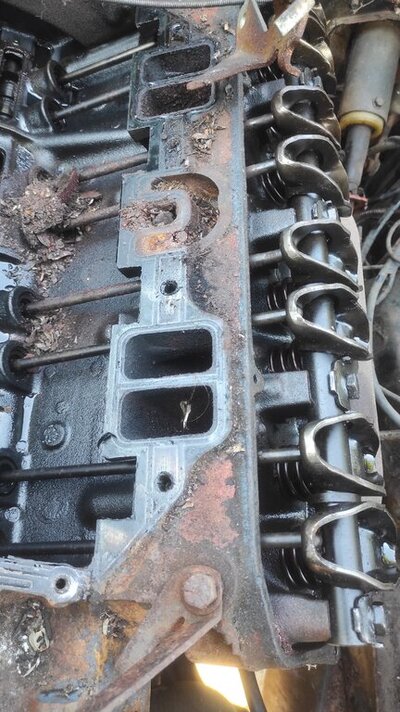

So a friend came by to help see what we can do. As we discussed here too it was best to remove the heads and see what we were dealing with. It was turning to point and then it was stopping with a metal sound.

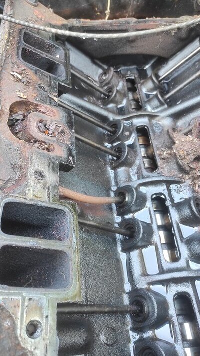

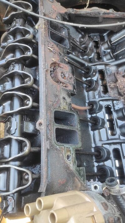

We got the carb off, then the intake. The valley pan gasket was rusted and had a hole. Crap had fallen inside the camshaft etc.
Anyway, 2 pushrods were bent on the passenger side.

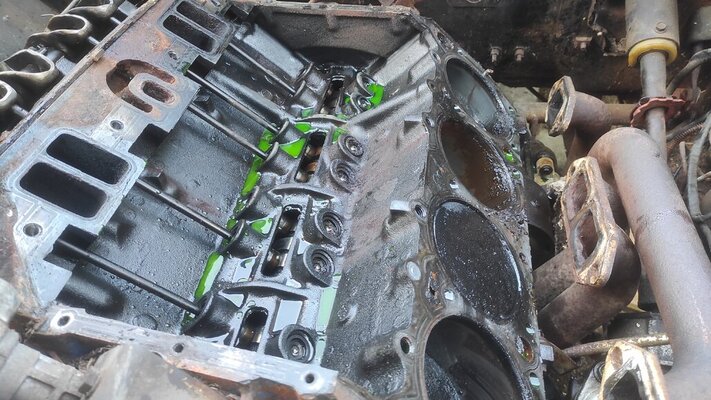

Now to remove the driver side head. It was hard, it didn't seem like it had ever been opened before.

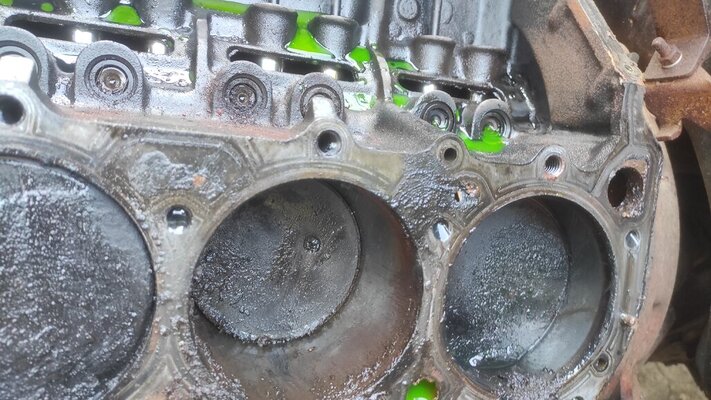

Bad news, despite the bent pushrods being the passenger side, the driver's side had a broken valve on cylinder number 5 and the piston has good dent.
We tried turning the engine again and it would still stop at a point with a metal sound so I suspect the passenger side will be even worse unfortunately. We didn't have the time remove that head today.
What could have happened and it did that kind of damage? To more than one cylinder?
Pictures follow.

With that amount of stuff falling into the lifter valley I personally would not feel comfortable without taking it all the way down and check the bearings and cam and crank journals. Really means that engine will probably need to come out

Overhaul time it looks like. Sorry for the bad the luck. Think we all have had to rebuild these old motors. Mine ran and drove into the shop. But after pulling it found it needed to be bored 30 over. Had to get another block to get less boring on the cylinders only 20 thou. I am not fond of sleeves in a motor. Just wonder if when buying the car if the seller was straight forward on the motor condition. Wish you luck and might as well make a stroker out of it.
I might have exaggerated a bit with the crap that fell in. We vacuumed the vast majority of it. Wouldn't a plentiful oil bath send everything else down the the oil pan?
Thank you Russ. It's a bit early since I need to inspect the passenger side as well that had the bent pushrods but does that dent on the piston take the engine out completely? Should work in theory but it would lose compression?
I was surprised to see that Sublime Green coolant though. But should have looked for a drain before pulling the head.

If it where me would get new pistons and what have you. Like said total rebuild would be the best thing then you know what you have.

Never tempt fate. Murphy’s law says anything that can go wrong will and at the time that can cause the most damage. If it’s in the oil you are counting on an oil filter to save you. At this point I personally would pull the engine, break it down and check the bearings. They are cheap to buy and expensive to repair if damaged. Usually means crank journals, cam bearings all need polished if lucky and turned if damaged or outright replaced if really scored or damaged. Best of luck to you

Check crank bearing registers to make sure they are tight. If you look here in the manuals, you will find out a lot on these motors. Mancini Motors is a place to call for parts. These cars came with cast iron head. Too tell if the heads have been altered is to know the depth of the compression area. Or where your valves are. Use a flat edge and check distance! Do you have any machine shops that can work on our motors.

My impression is that engine doesn't have too many miles on it, relatively speaking.
Not a lot of "gack" on the rockers or valley.
And whatever happened locked it up pretty quick after the valve timing went kaput.
Then it just sat.
So the damage the the bottom end may be low or non existent.
Get the other head off and see what you find on that side.
Pull the timing cover and check for jumped timing.
Pull the oil pan and see what you find.
Then it just sat.
Dash says 71something thousand miles. There is a good chance from what I remember from the seller also that the car was sitting since '78 when it also got a new registration and a new vin tag for some reason.
I will continue the disassembly as soon as possible and keep everyone updated. Thanks
