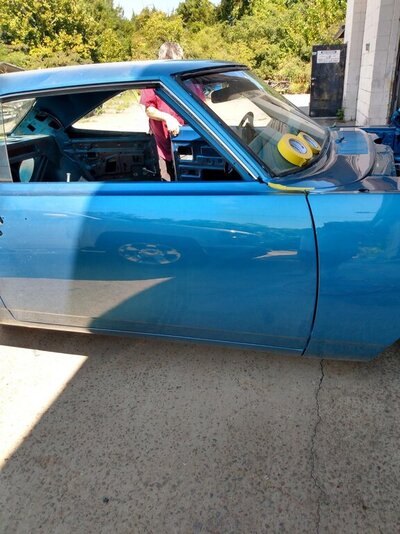

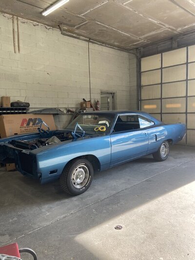

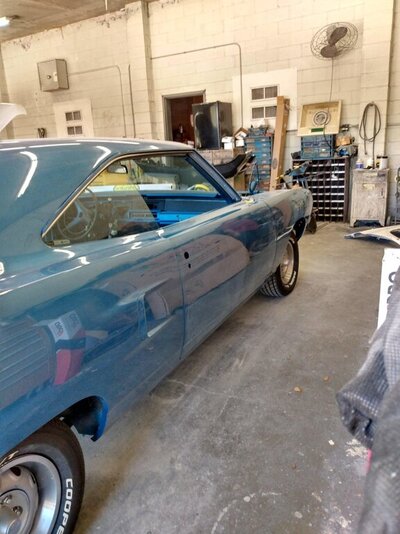

Update on the 70 RR. Got the doors back on and working on the front end.
Here you go Russ, I promise to stay focused on the car. Lol.
7,716
3,254
Oh man that is looking like a winner. Coming along fine. You will be proud when driving that one. Keep up the good work and you will be wheeling down the road soon. :thumbsup2::beep:
