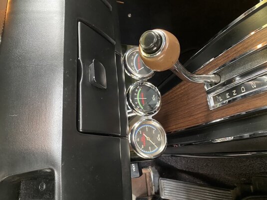

Recently purchased a 69 A12 Clone/Tribute. 440+6. 727. 3.54 Dana My car has factory bucket seats and floor console. Is there anyone who is using a currently available shifter replacement gate or has modified the factory shifter gate such as adding a stop between drive and neutral? . Twice now when manual shifting the car I have went into neutral at high rpm. I am open to an aftermarket shifter. But do not want to alter or cut the factory console or brackets. I noticed a company makes a gate plate for a reversed pattern valve body but a call to a representative from that company stated that he didn’t know if it could be used for a standard pattern. Thanks.

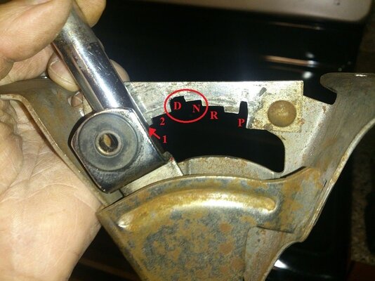

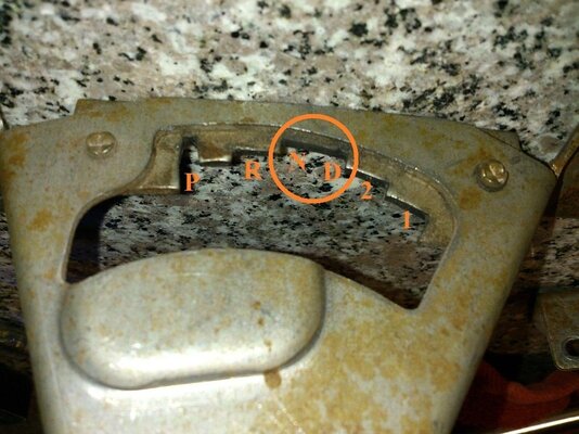

If anyone else might be considering this issue..I found this on another forum

Ok that is what it thought. Would it be possible to make the notch deeper where drive slot is to stop it from going to neutral. Maybe their could be a tab welded on. Maybe someone here knows if that would work. If in neutral you just pull it to drive don't seem right to me. Their is no safety factor due to it could be bumped into drive by accident. Hope you get it figured out and why it is this way. It might have been altered at some time during it's life.

that is a 68/69/70 style in 71 the slap stick had a lock out . nhra would fail that in teck as it would go into neural and blow the trans .that is why there so many revers pattern valve body's

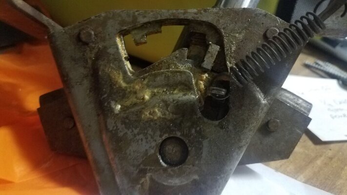

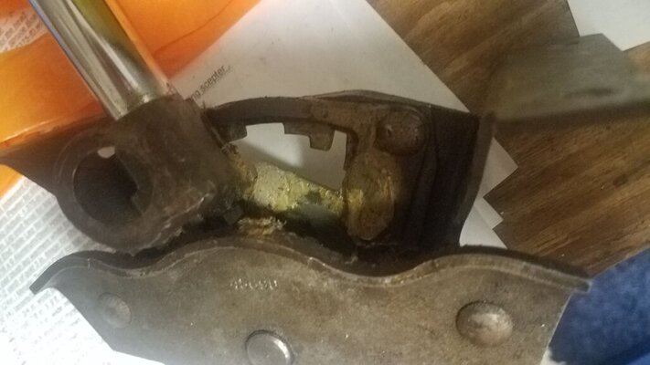

Here is a pic of my slapstick for a 70 barracuda. It is different at the bottom; it has a locking mechanism that doesn't allow you to go from D to N. BUT, you can go from N to D quite easily (at least with the shifter sitting on the bench). I would think this is not a good thing and I still would like some kind of detente between D and N. Maybe instead of making in a flat notch with D being deeper, have a small piece extend out between N and D. This way N can "lock in place" as well??? Could a piece be welded in? Can you weld onto this type of metal?slapstik.jpg

if it looks like the shiftier in post 12 then you are good to go if not you should do the mod you found of a different valve body you don't want to go in to neutral it will brake the trans.

Here is a pic of my slapstick for a 70 barracuda. It is different at the bottom; it has a locking mechanism that doesn't allow you to go from D to N. BUT, you can go from N to D quite easily (at least with the shifter sitting on the bench). I would think this is not a good thing and I still would like some kind of detente between D and N. Maybe instead of making in a flat notch with D being deeper, have a small piece extend out between N and D. This way N can "lock in place" as well??? Could a piece be welded in? Can you weld onto this type of metal?View attachment 35002
Don't see why you could not weld a small piece on it. Grind it down the way you want it.
Yes, that is my 70 ebody shifter in pic #12. Good to know that I am good to go.
