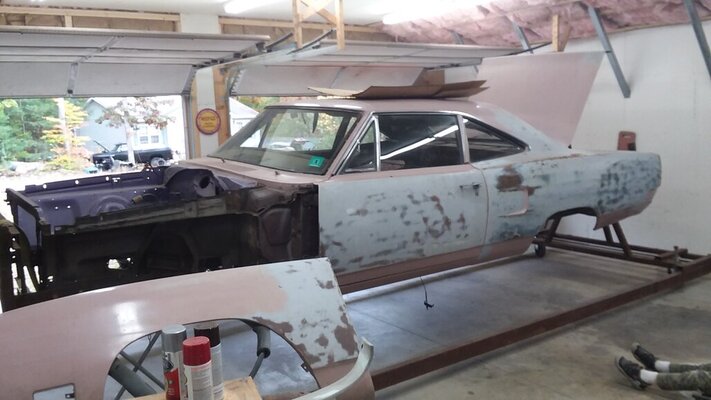

I actually have to support mine on jack stands before I cut it apart anymore so I can get the new trunk and quarters welded on as I don`t want it to sag on the rotisserie. Iv`e had my garages heated with wood, then oil and now propane - it`s a necessity up here in the crappy, freezing cold New Hampshire winters. I`ve been trying to convince the wife to move south to the Virginia area but haven`t quite pulled it off yet.

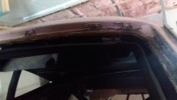

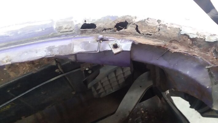

That second clip on the window trim dose look out of place. I don't remember there being a bigger one up there. I could be wrong. That rot on the lower window frame is because of the seal leaking in the corner. These cars are noted for doing that. Had a small spot in the passenger side corner also but now where as bad as that good luck.

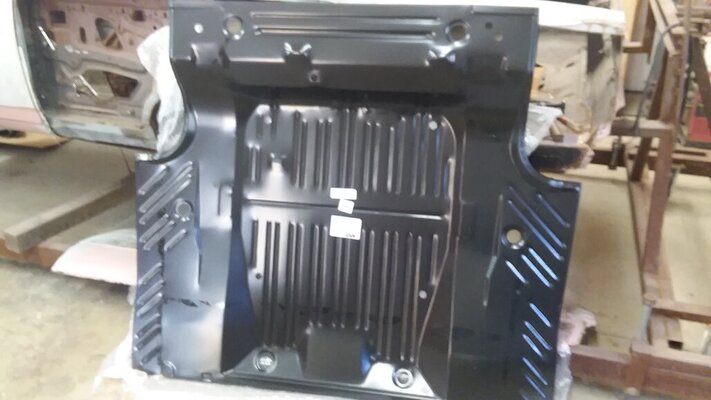

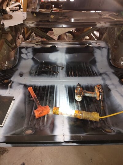

Trunk floor showed up today!
Nice. I hadn't intended to remove the tail panel so I bought two half trunk pans. That was 2010. But now that I am back working on it I found major rust on the rear crossmember I removed it and welded them together. I have the whole trunk screwed together. Once the quarters are on I'll start welding it all together
7,716
3,254

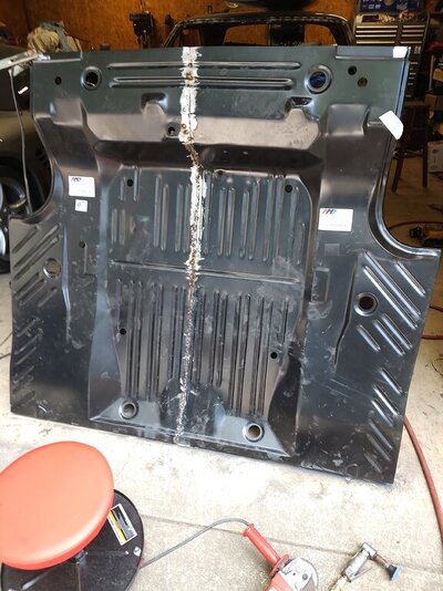

Don't know but my trunk pan was off center. Had to cut off one side and add to the other side to center it up. Darn aftermarket parts. Won't say where I got it, but it is where everyone else is ordering from. LOL.
MoparDan
Mar 15, 2021
544
607
Stuarts Draft Virginia.
They are cut off center. I put the two halves in and screwed them to the inner wheel wells. Then screwed the two halves together. I ran my cut off wheel down the center of the overlap and welded them up. Here's a pic of it in place
