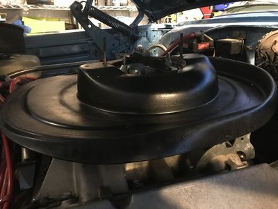

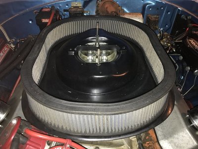

For what it's worth I am also running the 3 inch tall K&N air filter replacement as well, and the fiberglass drop base that I cut down gives me plenty of room under the hood and doesn't interfere with the carburetor or throttle linkage at all.

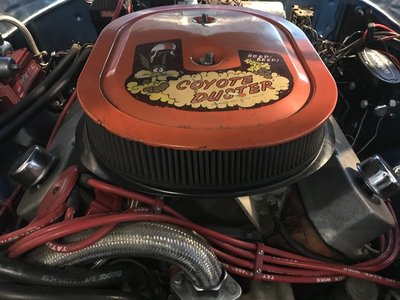

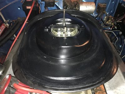

IMG_0037.JPG IMG_0038.JPG IMG_0039.JPG As promised...edelbrock performer rpm intake, fiberglass drop base (cut down an additional 1" or so where it sits on the carb), and a K&N 3" filter. For the purists out there, yes, it is the wrong air cleaner cover and actually belongs on a road runner, but it came on the car years ago and I like it so I'm keeping it...

GREAT pictures Dan. Thanks for taking the time and sharing this info..............
That is one large filter element............

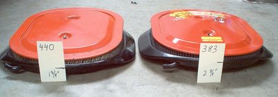

Looking at the attached picture I have of the 440 and 383 air cleaners, I can NOT figure out which one you purchased and cut down.
The 440 cleaner is an inch lower than the 383. ¿ Do you remember which one of the two you cut down ?
It is starting to look like if I use the 440 unit and the shorter air cleaner element, I might be able to install it all WITHOUT having to cut anything. Since my motor is lower and the 440 element is lower, plus using a shorter filter element..............all might off set the fact I have a high rise manifold over stock.............this may very well give me plenty of clearance.
