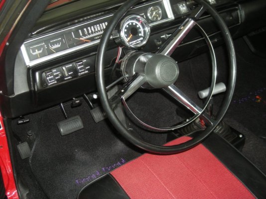

Can anybody please tell me how to get the silver trim piece around gauge cluster off without tearing the whole dash apart I tried u tube they don't show exactly how thanks!:praying:
V.R.D
Oct 27, 2020
479
566
florida
it has to be removed the screws are from the rear
