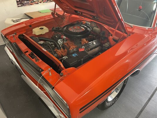

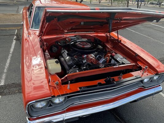

Hey guys, trying to fix up the engine compartment
Need to find more correct things like:
Emissions decal
Yellow rad decal.
My car was built September 69, I know there’s a late emissions decal and an early.
Plastic looms for washer bottle hose “the white plastic ones"
should i change the valve covers to the orange ones or paint wrinkle black? I do like the orange ones better.
what about my air cleaner?
My air grabber was added, so it has the wrong air cleaner, wondering if i should leave it alone or not?
Heater core is disconnected so theres that too.
I did order a washer pump motor and battery hold down, id love to take the manifolds out and have them cleaned up i will add better pic later
thx for your input

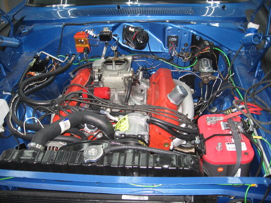

Under hood strap kit form parts mix. has the white straps that hold wires and other hoses. Work with a clip through the inner fenders. Can see some of them in the pic.IMG_0103 (4).JPG
7,716
3,254
Yes, a lot of work but with the right straps and ties you can do a decent job. LOL Oh sand blasted my exhaust Manifolds then painted them with product from Eastwood for heat exhaust.

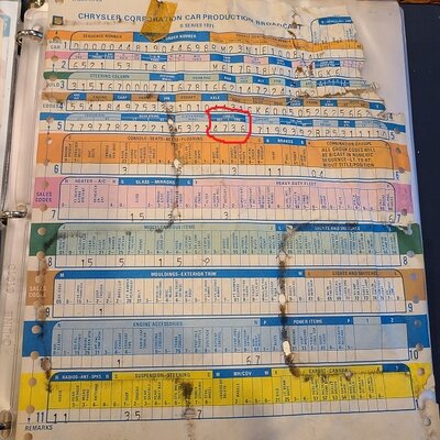

If you have a build sheet, under labels you will find the correct number for the emission and tire pressure decals.
Johnnyscarnuts
Johnnyscarnuts
May 4, 2019
421
261
Tucson AZ
I got the correct emissions decal coming, There’s an early and a late not sure where the tire pressure decal goes Thx!
