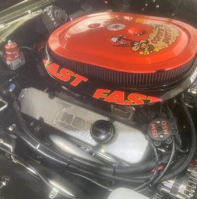

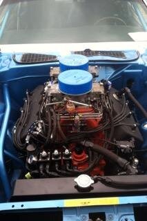

I have a Griffin Exact-Fit radiator, with dual 12-inch electric fans and a custom stainless shroud in my 69 Road Runner It does an excellent job maintaining an acceptable temperature. I've had it out in scorching heat (100 +) with the AC on and the temp will run between 200 and 215. The engine is an Indy 572 MAXX Wedge with the Mega Block and aluminum heads and the EZ FAST-2.0 injection system. The engine was built for racing and has all the internal components to maintain any kind of abuse I can throw at it. It dyno'd at 918 HP at Indy and 810 HP at the rear wheels following break-in driving... so the radiator and fan setup is doing its job just fine!!
